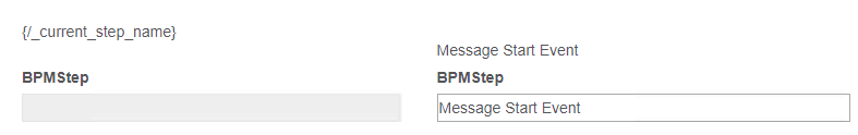

In the sample below you will see 2 fields: (I would suggest they would be hidden).
  • A Custom HTML Field that contains the HTML variable {/_Current_step_name}  (css class CurrentStepName)
  • A Single Line field BPMStep (css class BPMStep)
When a User Task is opened the Custom HTML field automatically updates with the value of the Current Task Name allowing me to know what step I am at.
Using JS I capture the Custom HTML Text and input it into the BPMStep Field
  $('.BPMStep input').val($('.CurrentStepName').text());
  $('.BPMStep input').trigger('change');

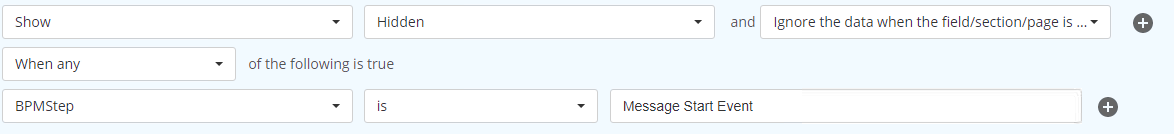

I then use the BPMStep field to create Field Rules as to when to show parts of the form

Just an Update on this, If you use CurrentStepID instead of the variable CurrentStepName, and you use a Number field for BPMStep, you can then create rules based on the StepID which each task has opposed to the Name of task which would change if you used a Variable in the Task Name and hard to identify.
As the BPMStep field is a number field you have equals, greater than, less than, etc available to you in the rules. To only Show fields after the original form is submitted, the rule would be BMPStep is greater than 1. Or you could set rules such as Show Fields or Sections when BMPStep equals 5 or maybe greater than 4 and less than 6. Lots of options are available this way
