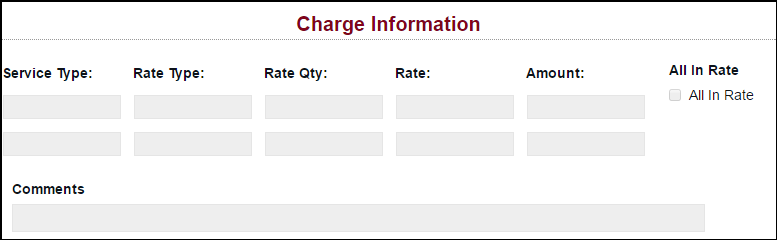

I am looking for a way to dynamically set the number of rows to display in a table based on a lookup.  My lookup will return a count of the rows needed to populate in a hidden field (q142).  Then the data will return an populate each row of the table with the corresponding data.  I've included an image below to help further explain:
As mentioned, the lookup will return a numeric value that will represent the number of rows that should be display in the above table.  Any help is much appreciated.

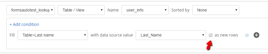

If you are using lookup to fill the table with data, then I would suggest using "fill as new rows" option on lookup, like this:
With this option, the number of rows is set dynamically based on lookup return data.
