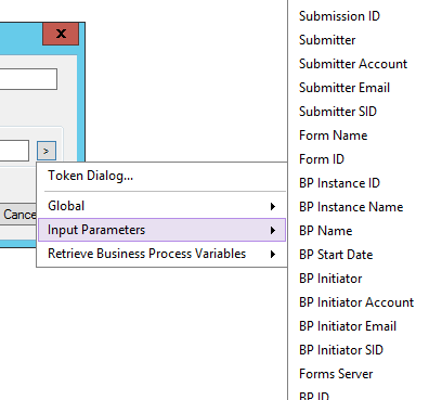

Did you enable the workflow properties to include 'Started by Laserfiche Forms'?
(click the green start activity and then 'View workflow properties' in the right corner.
Once you do a new set of tokens will be avaliable, including the instance id.
