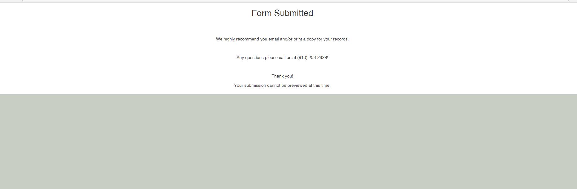

I have an instance where a user submitted a form,   they got to the thank you page that states that the form was submitted,  but the message Your submission cannot be previewed at this time is displayed.    I have looked through the event viewer in the Windows Logs - Application and System,  I also looked through the Applications and Services Logs - LFForms with no trace of errors or warnings.
I cannot find the document in the repository.
I can find no trace of the submission.
Any suggestions where else to look for cause.
Attached is screenshot of thank you page.

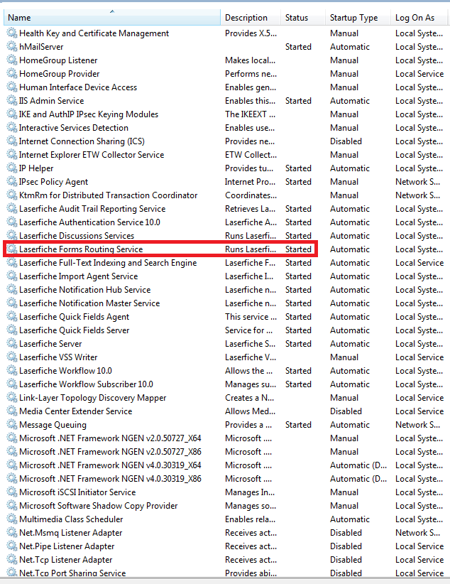

Have you checked whether the forms routing service is running? You can go to "local services" in your windows explorer to see a list of services that are running by making sure that their status indicate "started".
replied on December 29, 2016
Yes routing service is running,   i have had several forms submitted before and after the one in question.   So i know the process is working,  i just can not find any trace of this submission.

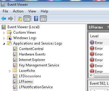

Check the Event Viewer to see if there are any errors. It is possible if the error is generated before the Form Server generates an Instance that this is why you are not finding it.

I have checked through all the event Viewer,  there are no errors,  I tend to agree with your statement if the error is generated before the Form Server generates an Instance then no error is logged.
The problem with this is that the citizen is told that the form was submitted,    So if this is the case,  is there a way to detect the problem in the thank you message to clearly state to citizen that the form failed to submit.

I am putting text in the thank you message that if form preview does not show then there may have been an issue with submitting form.   But that is not great solution,  alot of users will not even read the text, they will only see Form has been submitted and stop reading.
