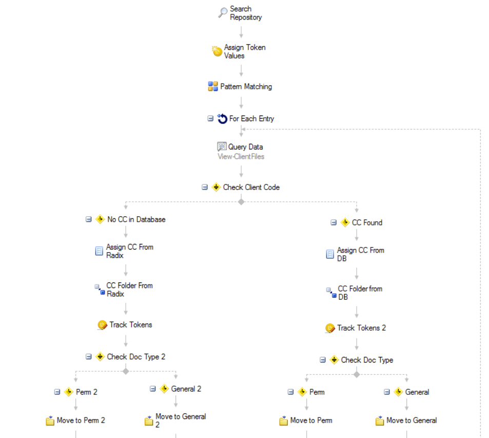

I have attached a screenshot of the Workflow. Any input would be kindly appreciated:
The idea is to have the file move to its correct folder based on a query to obtain its metadata.

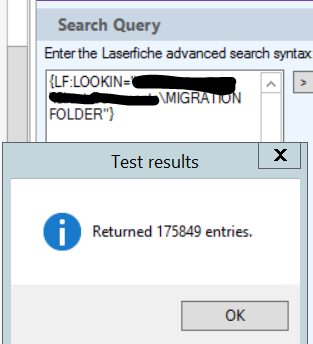

Is the "search repository" activity in the workflow the same one you showed that finds the 170000+ documents? And it's those 170000+ documents that you basically want to assign metadata to based off of an SQL query and then route each document to an appropriate folder?
If that's the case, then I would expect to see a "for each entry" activity after your search where the SQL query, metadata assignment, and entry move is done inside that loop for each document that was returned by the search.
However, you also mention running this as a business process and perhaps even running it on a per document basis. If that's the case, then is it not supposed to do the search and instead, just do the SQL query, metadata assignment, and document move just on the selected document(s)? If that's what you're trying to accomplish, then I think removing the "search repository" activity would better allow it to be used as a business process.
If you are trying to accomplish the former, then perhaps having this run as a scheduled workflow would be optimal.

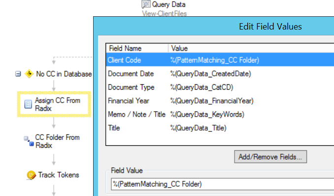

Further to the above, I am getting a 'One or more required fields were omitted or had a blank value. [9066]' error when i am checking the error log Workflow Administration Console. This is when I have the Worflow run on a scheduled task. No documents Move at all.
I have 2 fields that are required, one is the saved by username (in this instance it will be Workflow), the next and for this error is pointing at a pattern match we created to obtain the folder name.
The error is for the following activity in Workflow - 'Assign CC from Radix' which is basically filling in details based on the Query and a Pattern Match (in this instance it is the Folder name). If you require me to open a case I will do so before I post the error log details.

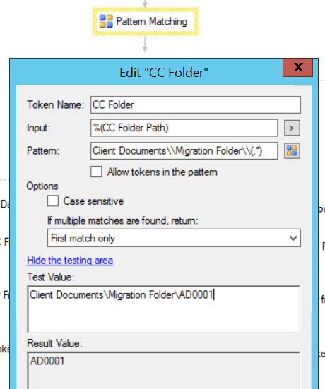

Can you confirm that the %(CC Folder Path) token contains valid data when your workflow is running?
replied on December 29, 2016
Is "Client Documents" the name of the repository? Entry paths do not include the repository name, so this pattern wouldn't find matches.
Also, please limit your search to 1000 entries or less at a time. Loops over very large entry sets are not efficient.
Hi Miruna,
'Client Documents' is a folder in the repository. It is not the name of the repository.
Hi Alex,
i will confirm this with track tokens.
Thank you,
Ziad
Hi Alex,
I have added a track token just under the pattern match and it does show me a result of the Folder name as required for the field. So I am still unsure why it would error out?

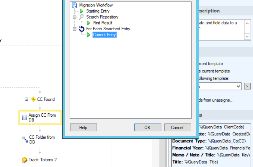

I have set this to run now on a specific folder that has about 20 documents (using Workflow 'Run Current Workflow') . The files move to the correct folder, but with that said, they all have the same metadata? I specified when assigning values to Each searched Entry - Current Entry.
If I select Starting Entry - only 1 file moves with the right data. I know I am doing something wrong, but would love to pin point it if possible.
Thank you
Ziad

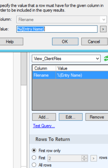

It's hard to guess without seeing the workflow. It probably has something to do with how your Query Data activity is set up.
Hi Miruna,
The Query data is shown below.
The above is how it is configured, the fields are basically getting populated from the Query,
Thank you
Ziad

replied on January 3, 2017
So what is the starting entry in this case? You're searching for entries, but you're using %(Entry Name) for the query. %(Entry name) refers to the starting entry, so the query results will always be the same and have nothing to do with the search results.
Hi Miruna,
Thank you for this, that was the issue! Once this was changed from %(Entry name) to %(ForEachSearchedEntry_CurrentEntry_Name) it worked fine.
