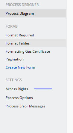

Hi Jason,
You need to remove the user rights from that particular Forms process.
Go to Forms (as an administrator)
Go to Manage and open the form process.
In the process designer Go to Settings - Assign Rights and you can manage the user rights for this particular process.
