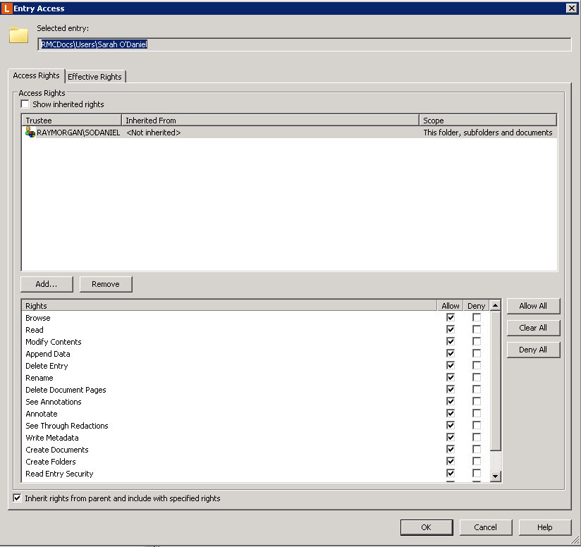

I have a tricky situation here. I have an existing repository that has been setup by someone a while ago. Almost everyone uses windows auth and there are a bunch of groups set up too. They have user folders setup but for some reason I can give this person full access to their user folder. Here is the way I have given explicit allow to her.

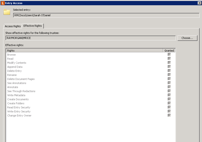

Here is what it looks like when I check her effective rights.
http://screencast.com/t/cx7KcRJ6
I cant find any Deny anywhere that is overriding my allows. I have tried the same setup with other users with the same results. I also tried the HR managers profile and hers did not give me the same trouble. What could I cross reference to see why one persons profile acts the way I want and the other one does not? Thanks.

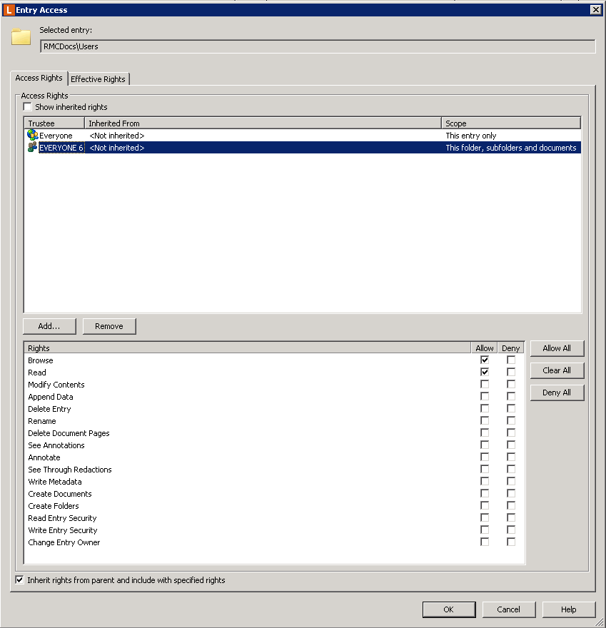

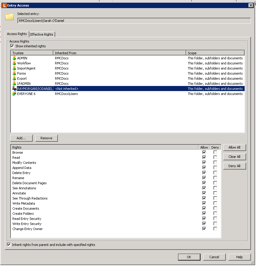

What shows up when you check the "Show inherited rights" box?
replied on December 20, 2016
replied on December 20, 2016 • Show version history
Is the user getting denied access via the inherited rights from the "EVERYONE 6" group? Or maybe the user or the "EVERYONE 6" group is read-only?
I dont thinks so but I also dont see where you can deny access via the group.
How would you set up deny in a group?
and no, the everyone 6 group is not read only.

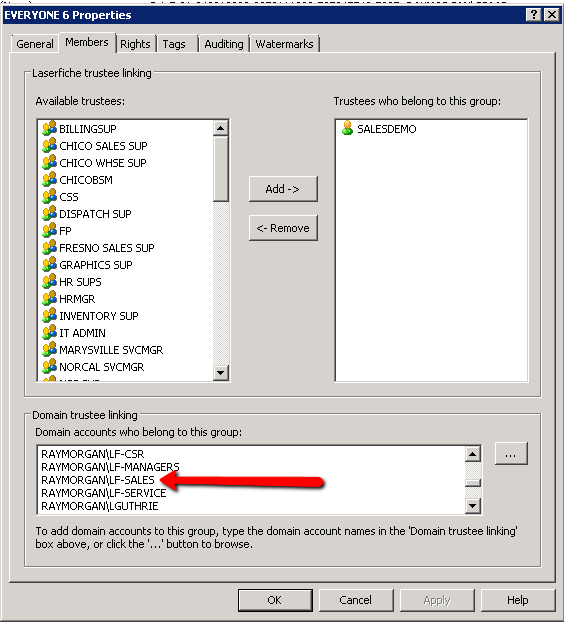

Is the user a member of the "EVERYONE 6" group? If so, then look at the actual access rights configured for "EVERYONE 6" on the RMCDocs\Users folder. Perhaps some access rights are being denied from there.
If that's not the issue, then confirm whether the user is read only or is a member of any other group that may be read only, since you've stated that "EVERYONE 6" is not read only.
the user is not a member or the Everyone 6 group but she is a member of a group that is linked as a domain trustee.
I'm not sure why it was setup this way. It's confusing to have a group linked to another group so i'm not sure why it was setup this way. I have looked for read only groups and I did not find any.

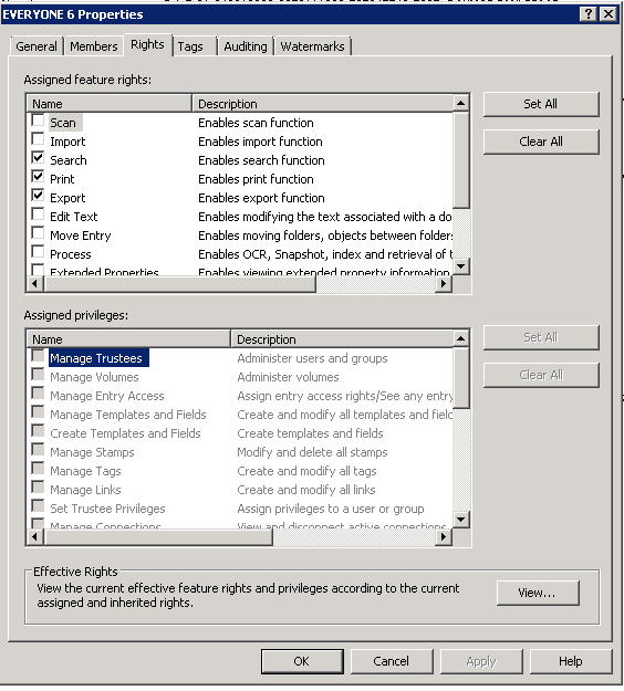

here is how the everyone 6 group is set on the user folder.
again I'm finding no Denys anywhere, plus its confusing that when I try to give her full access she does gain "see annotations" and "see through redactions"
