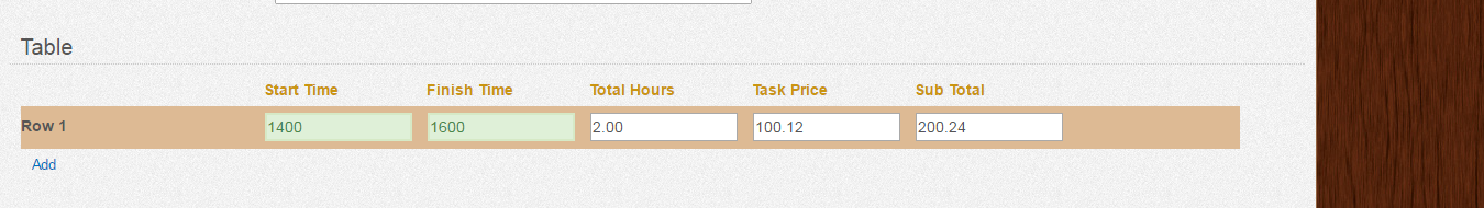

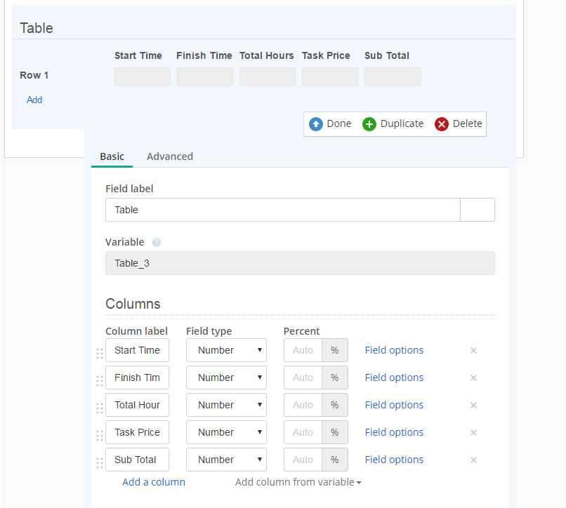

I setup a similar table as yours:
for "Total Hours", I use following calculation:
=SUB(INDEX(Table_3.Finish_Time,ROW()),INDEX(Table_3.Start_Time,ROW()))/100
For "Sub Total", I use following calculation:
=PRODUCT(INDEX(Table_3.Total_Hours,ROW()),INDEX(Table_3.Task_Price,ROW()))
And "Task Price" value is filled by lookup rule:
And it works when fill the form:
3 0

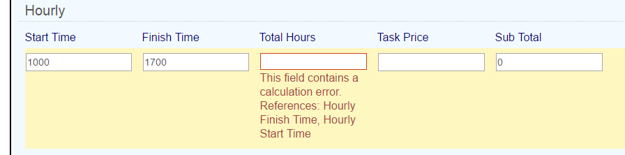

After some testing i found that the formulas are giving me errors in my form, but on another test system the formulas work OK.
Thanks all for your input its most appreciated.
replied on December 20, 2016
What error did you get ? Please check the variable names used in the formula are correct.

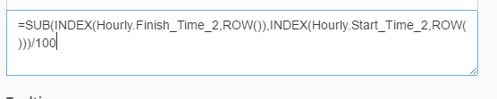

replied on December 21, 2016
This is the error on the form
this is formula
Variables -

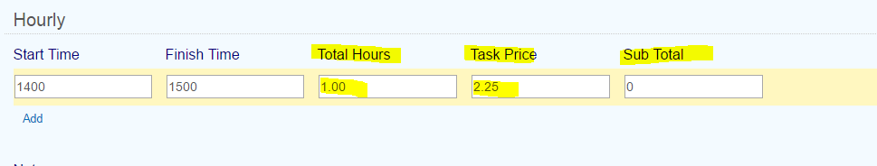

replied on December 19, 2016 Show version history
Hi Steve
I have used some of the calculation formulas in this form, but for some reason this one doesn't work (the subtotal just stays at 0) in this particular part.
=PRODUCT(INDEX(Hourly.Total_Hours,ROW()),INDEX(Hourly.task_price_hourly,ROW()))
This is why i thought JavaScript might be a better solution in this case.
Perhaps double check the variable name for the table and fields.  Frequently the variable name will get a _1,_2,_3, etc. tacked on at the end if you change the variable type.  (I.E. Single Line to Number).
