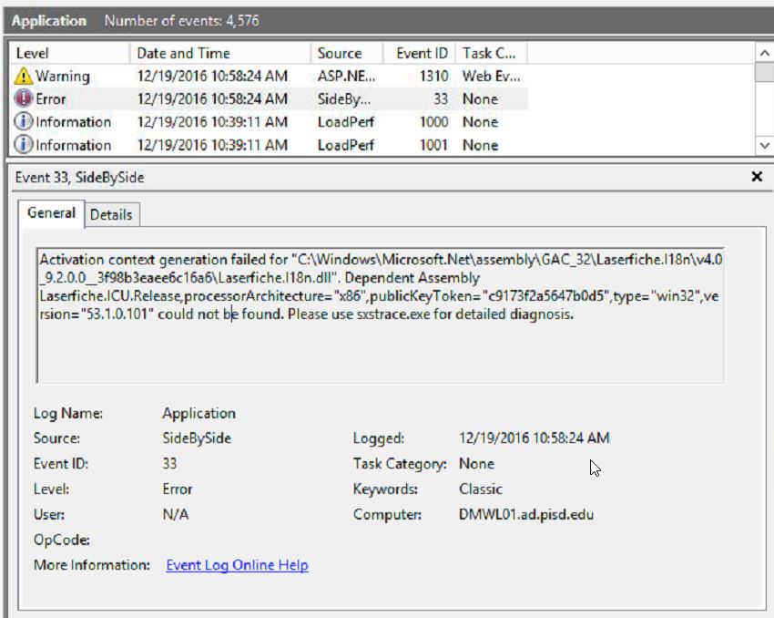

I am receiving the following error when I attempt to open a web page that uses the Laserfiche SDK files,
"Could not load file or assembly 'Laserfiche.I18n.dll' or one of its dependencies. The application has failed to start because its side-by-side configuration is incorrect. Please see the application event log for more detail."
You can see the additional error within Application Even Log. I am trying to figure out how to obtain the 32-bit version of 'Laserfiche.I18n.dll' and where within the windows directory do I place/store the file.

There are multiple versions of that library, corresponding to the different versions of LFSO. Your screenshot indicates you referenced version 9.2. So you need to install the 9.2 SDK Runtime. The installer will place it in that location. Its dependency, Laserfiche.ICU.Release will be installed to C:\Windows\WinSxS.

Do you have the 9.2 SDK runtime installed?

No, I don't. The only thing installed on the server was Weblink 9.0.
I installed 32 bit and 64 bit version of 8.0 SDK. I also installed 9.1 SDK.
When I couldn't get the error resolved, I tried copying 'laserfiche.I18n.dll' folders within GAC_32 from another server that was working thinking I could resolve the issue.

Installing the SDK runtime is the only supported way to get the required libraries on the target machine.

It's the same exe for x86 and x64.  Which dll are you asking the location for?  The path in your screenshot looks correct.

I am needing 'Laserfiche.I18n.dll'. The 32-bit version sits in the location that is displayed in the screenshot? Is that how I tell it is the 32-bit version?
replied on December 21, 2016
