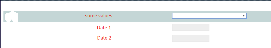

Hi All,
i have a form like the below, How can the date 1 and date 2 automatically change depend on the drop down values
like if i select "First Quarter"  from the drop down values i want the date to change to
date 1 : 1/1/2016
date 2 : 31/3/2016

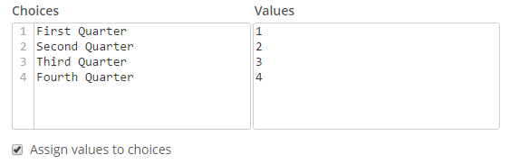

This assumes that your dropdown has these choices and matching values:
It also assumes that your dropDown has a CSS Class of "dropDown", and your two date fields have CCS Classes of "startDate" and "endDate".

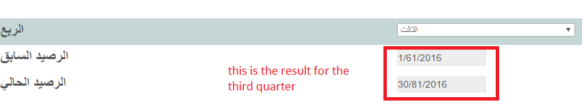

yes it is populating the date but not correct ...
replied on December 13, 2016 • Show version history
Oh, that should be a very easy fix.
The problem should be in lines 14 and 22 that I gave you before:
var d1x = d1.getDate() + '/' + d1.getMonth()+1 + '/' + d1.getFullYear();
var d2x = d2.getDate() + '/' + d2.getMonth()+1 + '/' + d2.getFullYear();
The functions getDate() gives us the day of the month (1-31), getMonth()+1 gives us numerical month of the year (between 1 and 12 - we have to add the 1 because Javascript usually uses 0-11 for the month), and the getFullYear gives us 4-digit year (i.e. 2016).
These two lines of code are just taking those three values and putting a / symbol between them.  Based on your original question, I posted the code assuming that your computer is formatting dates as Day / Month / Year (d/m/yyyy) - so third quarter would return 1/7/2016 and 30/9/2016.
If that is not how your computer displays dates, we would need to tweak those two lines of code.  For example, my computer displays dates as m/d/yyyy (7/1/2016 and 9/30/2016 for third quarter).  So on my computer I have to change the two lines of code to look like this:
var d1x = d1.getMonth()+1 + '/' + d1.getDate() + '/' + d1.getFullYear();
var d2x = d2.getMonth()+1 + '/' + d2.getDate() + '/' + d2.getFullYear();
