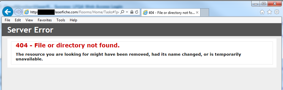

With default configuration, you should be seeing this:
It doesn't reveal any configuration information.  Don't be confused by IIS returning more information if the request comes from the local machine - remote users are given less information.  You should be able to change that also, it should be related to customErrors="RemoteOnly" in the root web.config.
