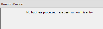

If I start my workflow with a condition, I get a message that no business processes are running.

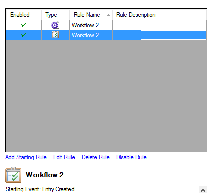

Here is my conditional starting rule added to a business process workflow.
Here is the state my workflow is in, currently waiting on an entry change
Here is my entry business process window
replied on December 6, 2016
Did you restart your Client after publishing this workflow?
That worked. Is there any implications to this? My workflows never required a restart before, is it safe to use this for instructional only purposes?
