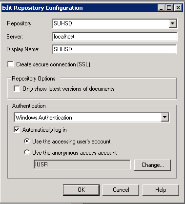

Are sure that you are authenticating as the same user?  Checking the connections in the administration tool will show it from the server's side.  The only other thing I can think of that would result in different listings would be the option to include (or not) non-current versions of documents.  This is configured in the WebLink designer.

I did double check the connection profiles.
I also check for the noncurrent version setting too and left that unchecked
