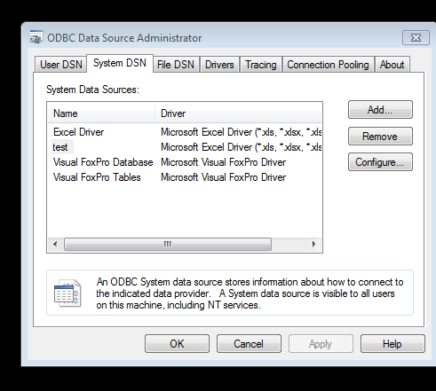

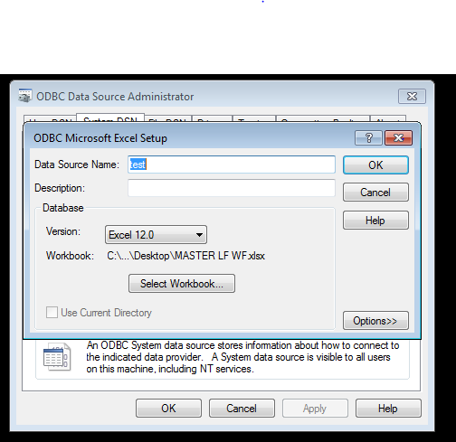

replied on December 7, 2016
This data source screenshot comes from the Workflow Server? Or from the workstation where you have the Designer?
replied on December 8, 2016
The work station where designer is installed.  The excel file is also local to the machine.
That's not going to work. The Workflow Server is the one who will be doing the querying, so the data source needs to be created on the server. The file needs to be accessible to the Workflow Server service user.
