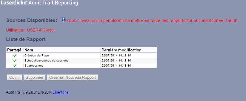

Hello,
I've installed and configure Audit Trail for the first time. During installation I've kept the default settings but now that I'm trying to run an audit I have an error message "You have no rights to run report. User : USER-PC\user" (see attachment).

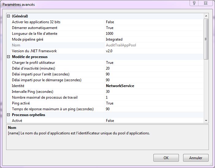

FYI, the Audit Trail Service is set to connect with local system account, in IIS, AuditTrailAppPool's identity is NetworkService and there is no windows user named "user".

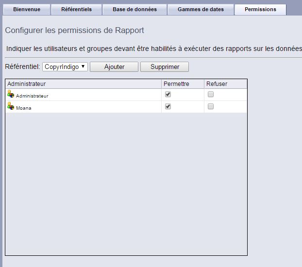

Can you confirm that the Windows user in question has been allowed permission to run audit reports for the repository? In the Audit Trail configuration page, click on the "Permissions" tab and make sure the user added there.
replied on November 30, 2016
Like I said there is no user named "user", the 2 existing users (Admin, Moana) have permissions (see attachment)
So USER-PC\user isn't valid at all? That's not an actual account that you can search for in the Audit Trail permissions tab?
I'm trying to see where it would be pulling that account from since that's who it thinks you're trying to access the Audit Trail reporting page as.

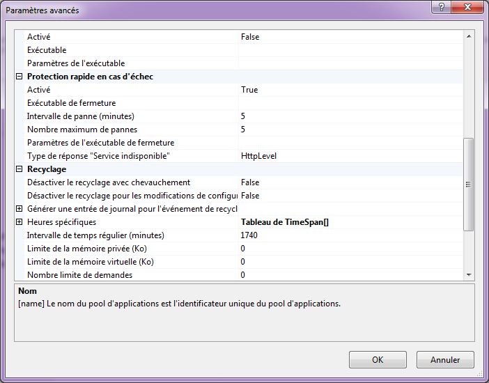

replied on December 1, 2016
How can I make sure that only Windows Authentication is enabled ? I'm looking to the AuditTrailAppPool's settings and I can't see that. (see attachments)

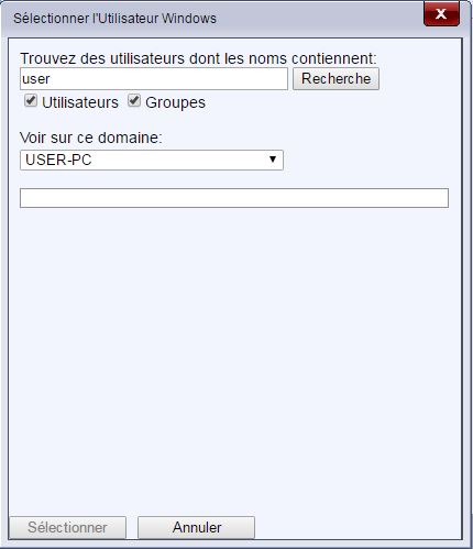

The whoami command return me "user-PC\user" even if on the Windows Authentication screen it's named "Admin". So I've changed back the account name from "Admin" to "user", reboot the computer and then tried to grant permissions to "user" in the Audit Trail Configuration but the Select Windows user's pop-up can't find anything.
Go to IIS > Sites > <sitename> > AuditTrail > Authentication, make sure only Windows authentication is enabled.
As to that you can not search for the user, please open c:\Program Files\Laserfiche\Audit Trail\Config.xml file, in the <UserPermissions> block, add the user to the Trustee list as below.
