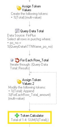

Try the following.  Create a multivalue token, do your Query, update the token by appending inside a For Each Row (make sure to use the iteration), and the a Token calculator activity.
Then use the calculator:
Fill in your field with the output of the token.

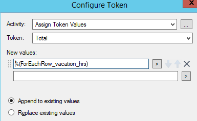

Version 9.2 has the append option. Be sure that when you create the initial token you check the box to make it multi-valued. Then, when you create another 'Assign Token Value' activity, click 'Modify...', and select the multi-valued token you made earlier, you will see the 'Append to existing values' option.

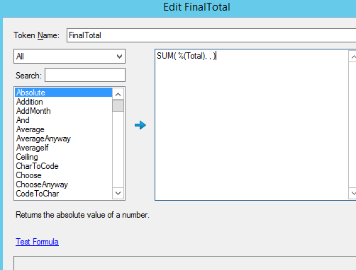

WF 10 is backwards compatible with LF 9.2. Everything Chris does is possible in WF 9.2. The token calculator will have a lot less functions available, but SUM works the same way: SUM(%(Total))

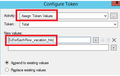

Thanks, everyone. I think I'm on the right track, but I'm confused about the screen shots above. How are you getting the '%(ForEachRow_vacation_hrs)' token in the Assign Token values activity? Shouldn't that be done in the 'Assign Field Values 2' activity? And how come you didn't select the iteration? It looks like you're selecting the db column for vacation hours.

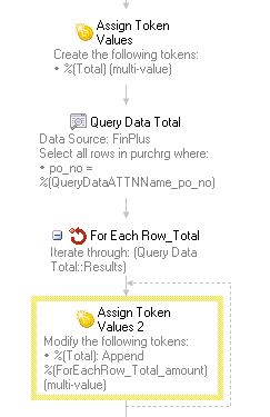

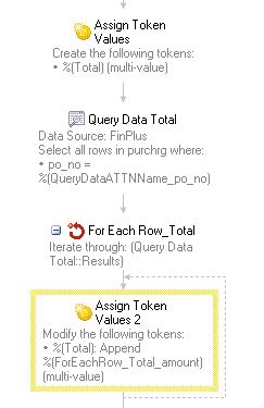

Here's what I got so far. Am I close? In the initial Assign Token Values token I haven't entered any value.

I just gave it a shot with this config. Please let me know if you spot anything that I should change, but it appears to be working. Can't thank you all enough for the help. You're all awesome.

replied on November 30, 2016
As for your question "How are you getting the '%(ForEachRow_vacation_hrs)' token"
You can simply select that using the token selector at the end of the line.  What you are doing is basically declaring a multivalue variable.  Then you want to populate that variable with all the numbers you wish to sum.  So you want to update the multivalue token with each and every value returned.  If you just did QueryData_vacation_hrs it would only populate the token with the first result returned.  Doing a For Each allows each value in all rows to be populated in the token.
Thanks again, Chris. I was asking that question because it seemed that the order of operations was incorrect because that token would not be available in the first Assign Token Values activity because it precedes the ForEachRow activity.
