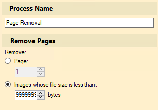

Thank you all for your answers. Finally, I kept the SEPARATION sheet at the end of each document and just change the font size of the SEPARATION word to a smaller one. This way I get a SEPARATION sheet under 10Ko and setting the Delete Page activity to delete every pages under that limit of 10Ko made the trick.

As you are using Separation sheets I would recommend you use First Page Identification to split on the Separation Page, possibly with Pattern Matching to Find "SEPARATION" or some other unique identifier on that page. Using First Page Identification the Separator sheet will become the First Page of the Document, then you can add a Page Removal Activity in the Post Processing area and set the Page Number to 1.

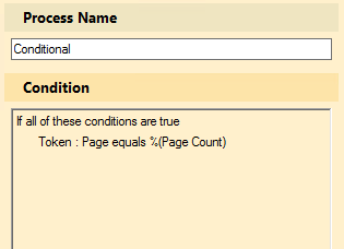

Hi Moana,
While I recommend using First Page Identification with unique form identifiers as Steve suggested when possible, here's a workaround to remove the last page of each document.
We'll try to provide an easier way to accomplish this in future versions.
