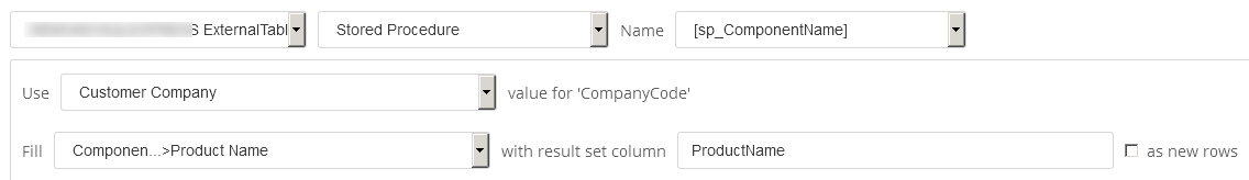

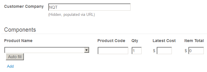

Again, my apologies for having made things so unclear.  Here's the process, hopefully the screenshots below it helps clarify things:
  1. The stored procedure ("SP") in the lookup rule requires the CompanyCode as a parameter, which is provided in the URL content to automatically populate the form from a link.
  2. On executing the SP, the ProductName column is filtered by CompanyCode and returns approx 100,000 results - in the SP lookup results "behind" the ProductName" dropdown field only at this stage.
  3. The table in Forms isn't populated automatically, so there isn't anything in the table until the user selects the "Product Name" dropdown field in the first cell of the table.  This is what is populated from the SP lookup.
  4. As the user selects the initial Product Name entry it only takes approx 2 seconds for the dropdown to populate for the first 2-3 rows, but then the performance starts to degrade for subsequent rows, even if they haven't used "Auto fill" to populate the remaining fields for any of the rows.
  5. If the user selects an incorrect Product Name entry and tries to delete the row or change the selection, the browser hangs - this is tested in Chrome, Firefox, and IE 11.
Here's the lookup rule:
And here's the table in the form:
Please let me know if there's any additional information you require.
