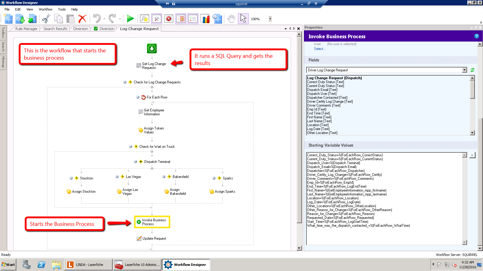

Attached are three files. The first is a screen shot of the workflow that starts the forms process. The first video shows the workflow starting and the variables that were passed. The location is not set to "Other" or the reason is not set to "Other". The second video shows the form that was created by the workflow both the location and reason fields are correct, but the other location and other reason fields are displayed. The field rules are also displayed. If I change the form from read only to read write if I change the location and/or reason fields the other location/reason fields go away. I believe the field rules are good, but the field rules are only updated with the fields are changed rather than when the forms loads.
