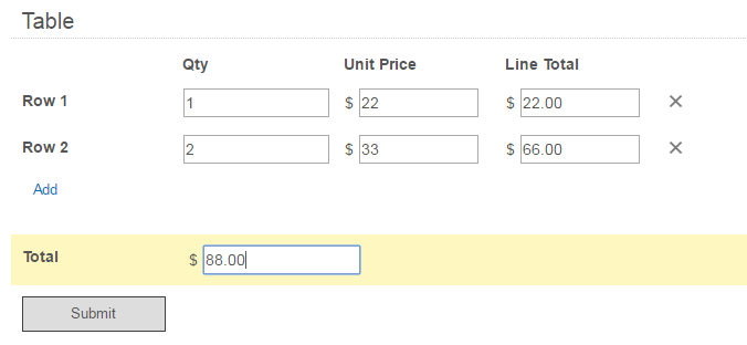

I have built a line item table for a customer using the Laserfiche samples for Total etc.  I have simplified it for this question.

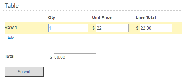

The calculation is correct when I add a new row.  However if I delete a row the Total keeps its previous value.  That is, the Total still includes the deleted row.
If I click into the table it will change.
Is there any way I can get the total to automatically update after a line deletion?  It would appear that Forms does not count this as a "change".

Table with two rows:
Table with second line removed; the Total is incorrect:

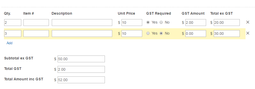

Complete table:

replied on November 16, 2016
Attached is a form Template as an example for you, just rename the file from .txt to .xml to be able to import into your Form as a Business Process.
Includes Calc for the Total and an IF statement for the Tax as per the picture you had posted.
