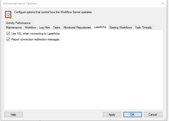

Hi,
I did enable SSL on the Laserfiche server and was able to enable SSL fo other components like WebAccess.
Is there a way to enable SSL between the Workflow server and the Laserfiche server when they reside on two separate servers?  I don't see a SSL checkbox like in the other modules that supports it.
replied on November 15, 2016 Show version history
You can do this inside the Workflow Administration Console under Server Configuration --> Advanced Server options. under the Laserfiche tab.
Thanks John,
I was expecting this setting to be in the Configuration Manager screen where you attach the repository.
Did not think it was hidden that deep.
Thanks again.
It's not per repository at this time, it applies to all connections Workflow makes to all the attached repositories (which can be on multiple LF Servers).
