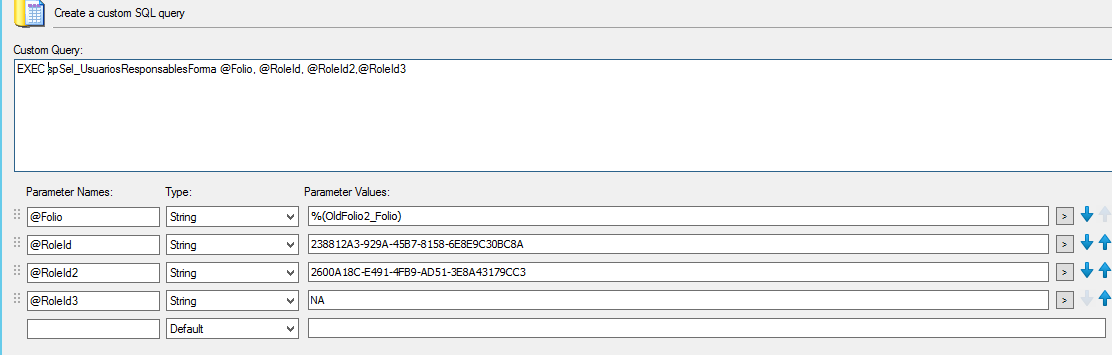

Hi Chris ,
Do you try to call your store procedure on a custom query?
Like this :

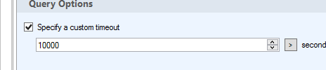

I thing there is not such limit just be sure to have your time out to the maximun allowed
3 0
replied on November 10, 2016
Ok, I can do it that way.  I guess I have always just pasted the SQL query syntax into the custom query box and not used the EXEC call.
Thanks David
