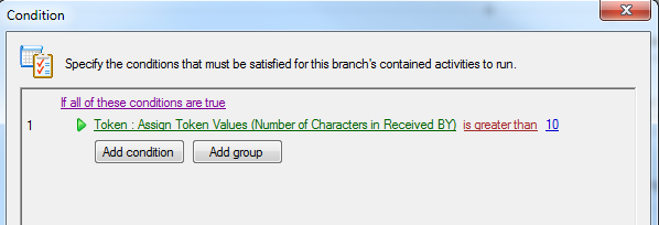

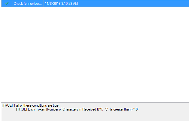

I am using the Text Length function on a token, which is correctly returning the length of the string as a result of a DB look up. When I perform a comparison in a conditional branch with this length vs a number, the comparison is not working.
So for example, if the token value is stored as 9, a comparison with greater than 10 is resulting in true, which is obviously incorrect.
Thanks!
See the example in the setup of the condition and a sample result:

Please tag your token as number instead of string. The default for Assign Tokens is to create string tokens.
replied on November 8, 2016
Have you used Track Tokens to Verify what the token values are during the process?
Did you use the Token Calculator to get the "stringlength" or use another method?
Have you tried setting the Assigned Tokens Tag to be a number (it defaults to String)
Thank you all for your replies! I've never noticed the token tags before and changed it to format as a number and the comparison then worked.
