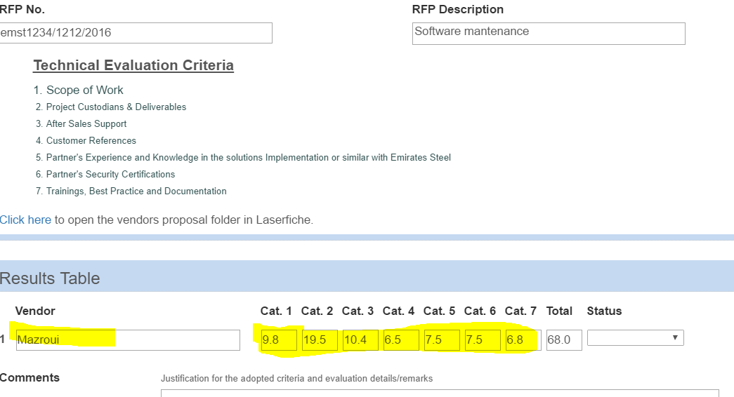

Hi,
Find attached the image of the form. Th fields in yellow were on the lookup. The total column should be the sum of cat.1 to cat.6
Mark

Hi Mark
I tried a bunch of things on your Table but ultimately was getting the same results as you. I have seen a couple times when making changes to Field Type (String/Number) once a Table has been created has produced some inconsistent result. I ended up creating a new table in your form, creating new fields and lookups and they worked right off the bat.
I'd suggest you delete your Results Table, and associated variables and build them again.
Attached is your form with my Tables and formulas included if you want to use those as an update to yours or for reference purposes.
