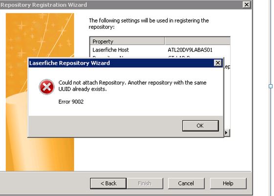

But what if there are multiple repository's already registered on single laserfiche server and we need to unregister and re-register only one of the repository on same laserfiche server?
When we are trying to do the above mentioned, we are encountering the error 'Could not attach repository. Another repository with same UUID already exists.'
replied on November 3, 2016
Ah, ok, so it seems you have a copied DB with the same UUID attached already. You will need to update the UUID so it doesn't match the currently attached repository.
We had updated UUID before attaching the database to the second repository and it was working fine until yesterday. But unfortunately we unregistered it yesterday and are trying to register it again.
Sounds like you might have to update the UUID again or something has gone wrong.
You can update it using the utility in the KB article here - https://support.laserfiche.com/kb/1012907/using-the-repositoryuuidupdater-exe-utility-to-modify-a-repositorys-uuid-
