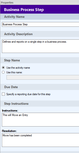

Perhaps I am just missing something obvious.
When using Business Process Step Instructions, the instruction is only available while in a Wait for Entry Change state.
Is their a way to Post and make available Business Process Instructions without a Wait for Entry Change?

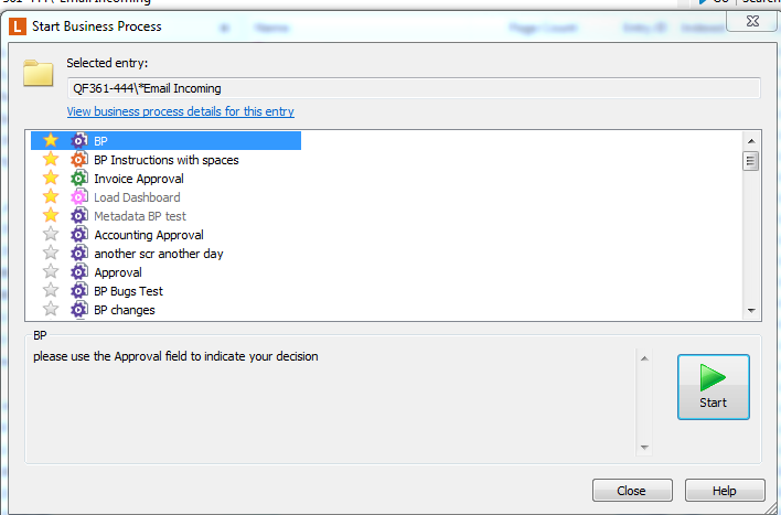

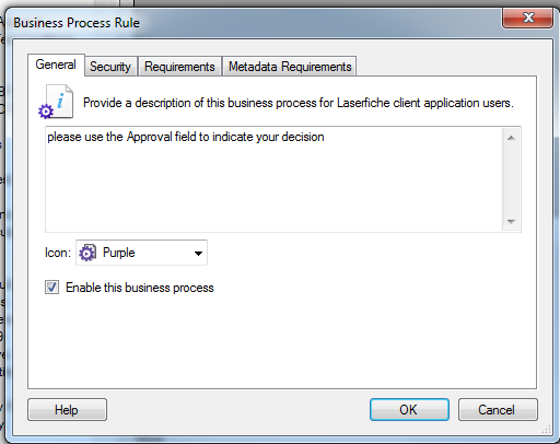

No, the steps will only work with wait conditions since as I mentioned above, Laserfiche wouldn't know when to display them without Workflow indicating it is still waiting on a user action.
I was referring to the business process' start conditions. You can add instructions there and they'll be visible from the Client.
Your other option would be to use email notifications when assigning the task to a user and specify the instructions there.

The instructions are meant for the user performing the action. If Workflow doesn't know it needs to wait for the user, then the instructions don't really have a point.
If you are designing your processes without wait conditions, you could make each step a business process on its own and add use starting instructions.

I assume you are referring to the Step Instructions for the Business Process?
Those require a Wait for Entry as well in order to Display an Instruction once the Step completes the Instructions are no longer available.
