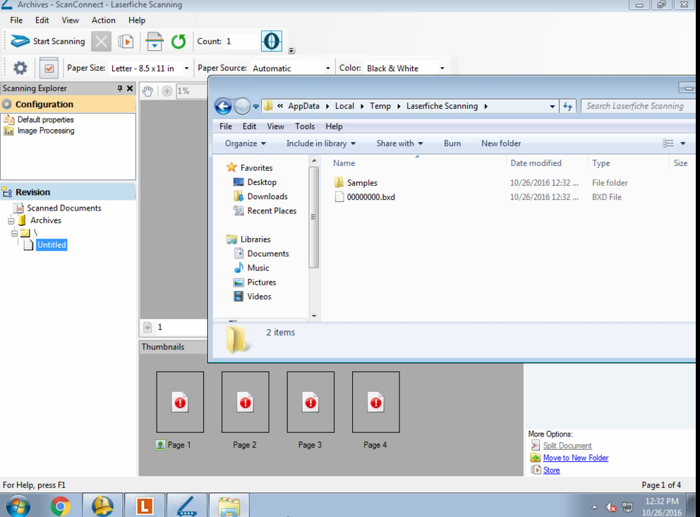

My client is having an issue where their scanner accepts pages and LFScanning creates the thumbnail boxes, but the thumbnail boxes have red exclamations in the middle. When I check the temp directory for lfscanning, there are no images in the folder. It's as if lfscanning thinks it successfully received the images but then found out they never came at all. We are using a Canon Dr-4010C, but we have tried multiple scanners(of the same model), and multiple users. The strange thing is is that TWAIN works fine, but ScanConnect doesn't. The users need scanconnect for some specific feature related reasons, so getting it to work is their desired option. They are on LF 9.2.1.635 and SC 8.3. Has anyone else has similar issues like this? Thanks!

The only time I've seen this is when page removal is occurring. Does your scanner have any page removal features enabled in the scanner options menu? If so, you might also want to check that the users are feeding the pages in the correct orientation. Page Removal + Upside-Down pages will definitely cause this.

We took another look and found that no page removal settings were set in the scanner's software. Would this be considered a laserfiche issue or a scanner driver issue(in your opinion)?
