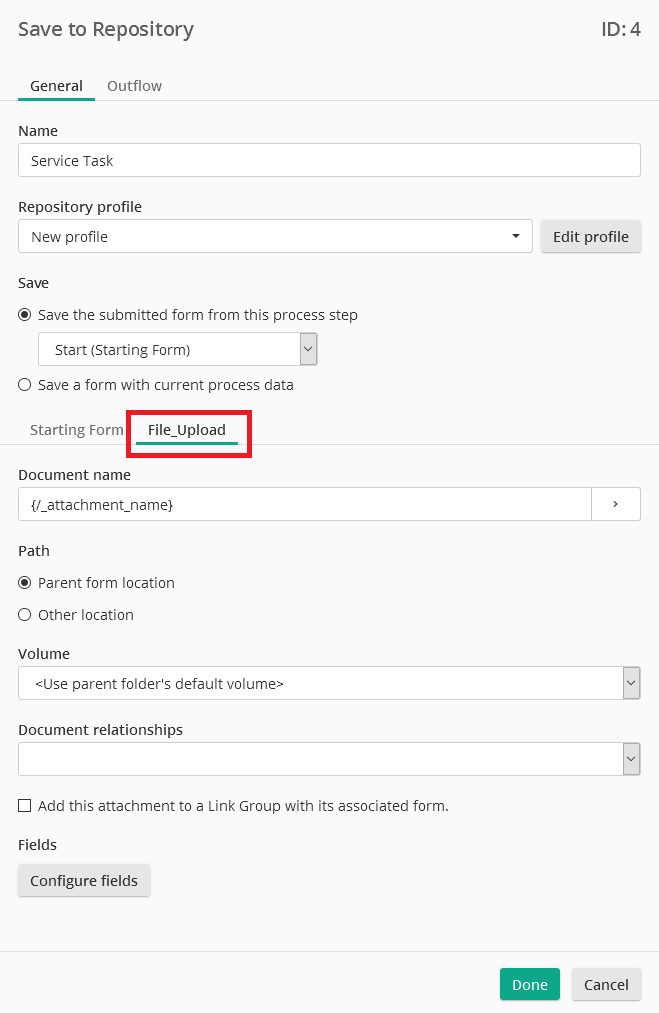

Can you provide the details regarding how you have the "File Upload" options configured in your "Save to Repository" task?
Next to where you configure the options for the form itself should be an additional tab where you can configure the options for the file uploads. See below

Thank you Alexander!  I was able to find the settings you were leading me to in your response.
I am seeing the attachment go into Laserfiche now (along with the form), and it is named and has metadata associated to it that was gleaned from the form.  I have not been able to get the attachment to be added into the form itself, so am doing that manually.

Are you referring to merging the documents together? Because the form that's saved into the repository will either be a TIFF image document or a PDF and the file uploads can really be any type of file, there isn't a good way to know what and when to merge files since you may end up with any number of incompatible file types.
With that being said though, you can make use of the "Document Relationships" option to effectively link the file uploads to the original form. Then when viewing the document relationship information on the document metadata, you'll see how they are linked together.
