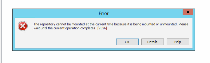

The repository cannot be mounted at the current time because it is being mounted or umounted. Please wait until the current operation completes. [9526]
asked on October 27, 2016

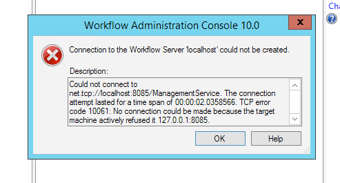

I am getting this error when trying to open up the admin console. This is on the server where laserfiche is installed and not a client machine. I've tried the IP address of the server as some of the other users with the same error have had but it is not working. Any ideas? I've included screenshots of the error when logging into admin console and workflow admin console. Thanks!

Is the LF server running? Can you login to it using the LF client?
replied on October 27, 2016 Show version history
I cannot. I get an operation timeout error [784]. The LF services are running too.
Yes, it is.
In the client, click attach and attach the client to the server using it's IP.  Does that work?
I was able to figure it out. It seems the SQL services were not running due to a login issue. I didn't even think to look at that until you mentioned the services. Thanks for pointing me in the right direction!
