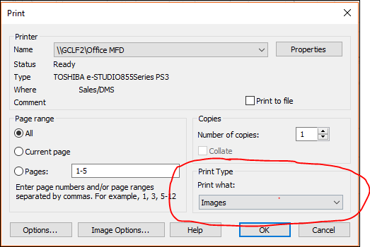

replied on October 27, 2016
From the Print dialog, make sure "Print What" is set to "Images".
Yeah, I made sure that was the case also. Thank you though.
