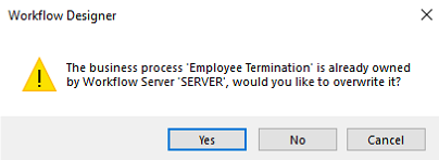

replied on September 15, 2022
What does this message mean? Where do I see the configuration for what server "ownes" a BP? That server isn't even hosting the WF service any longer.
