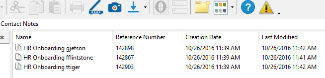

The form is saved into the repository with the metadata field 'Reference Number'.   Again, it will be unique for each form saved into the repository.

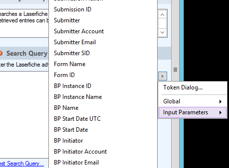

To see the default variables that forms passes to a workflow you need to tell your workflow that it will be initiated from a form.
Click the Green Arrow on your workflow, then 'View Workflow Properties' in the lower right corner, check the Attribute "Started by Laserfiche Forms".
You will then have a token set called Input Parameters available to your workflow that includes the unique submission id.  (useful for a variety of things )

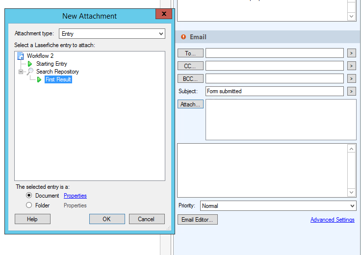

To configure the search repository activity I enter:
{[]:[Reference Number]="%(Submission ID)"} & {LF:LOOKIN="LFICHE\LFForms\HR_Forms"}
as the search ( change the folder to where you have saved your form )
The workflow searches the folder I specified for that unique submission id and I use that result in the email activity as my attachment to mail.

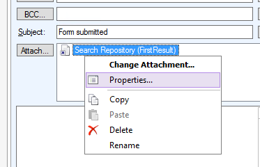

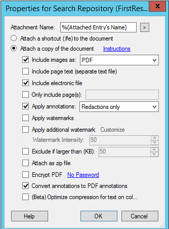

You will also probably want to tell the email activity to send the attachment as copy as it defaults to sending a shortcut link  back into the repository and unless the recipient has a license they will not be able  to view it.
Right click the attachment and select properties.
And select attach a copy of the document and any other options you need.
That should get you running.  Modify as needed!

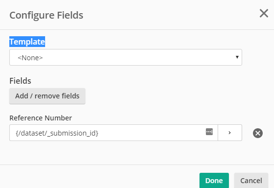

  1. In your form flow, save the form into your repository.  Using the configure fieId options, assign the field 'Reference Number'  to your saved form using the Submission ID  ( {/dataset/_submission_id} )   Of course you can use any field variable you like.

  2. Once your workflow finds the form it should be a simple matter to email it as an attachment using the the tokens created by your Search (entry id or path name).
