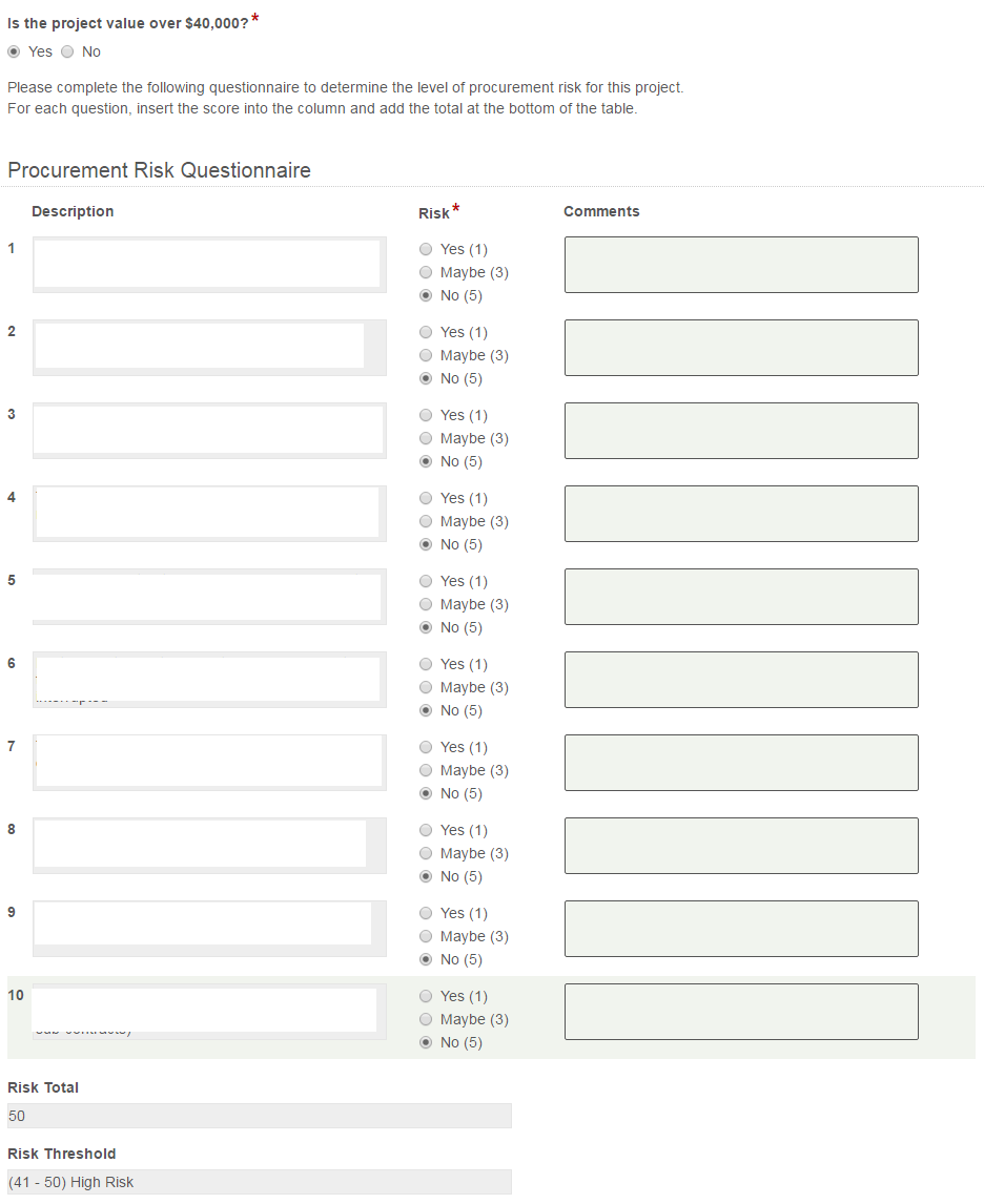

Please check out my table below. It populates 8 default rows from a DB under the Description column. My 2nd column contains radio buttons with numeric values assigned to each selection and Comments column is a multi-line field.
I am using the function =SUM(ProcurementRiskQuestionnaireTable.Risk) in Risk Total field (Single Line) to calculate the sum and based on the calculated value, the Risk Threshold field is displayed.
You have to select Yes in the Radio control before the table to display these three fields. They are hidden otherwise.

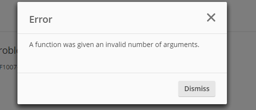

When approving, if I select project value to be over 40K and select Risks Risk total is caculated, Risk Threshold is displayed and the form submits without any issues but if I leave it as No and submit the form, the below error is generated.
I couldn't find a log of any sort in the event viewer. I don't think Table format being either Fixed number of Rows or Range of Rows is an issue as I have tried both.
