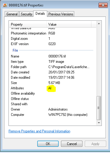

Looking in the folder, that file is not searchable within Windows – at least it is not found when doing a search on the right folder.
The reason is because of:
On the files that have this issue you will see an attribute contain a “T”, which means the file is a temporary file. We have tried getting this searchable but in the end we removed the “T” by using Powershell Get-childitem | ForEach-Object -process {if (($_.attributes -band 0x100) -eq 0x100) {$_.attributes = ($_.attributes -band 0xFEFF)}}
Once that is done Quickfields can see the file and stores and removes it successfully.
The access denied error seems to be a generic error message, as it is nothing to do with permissions – Quickfields cannot find the file.
Note that these files are written by Quickfields!
Hope this helps Laserfiche identify the cause and release a fix.

Thanks. Yes, Quick Fields places these files here but in most cases it's not actually creating them from scratch - they're a copy of the scanned originals. In that case, I'm wondering the originals had the "T" attribute and then the copy retained this attribute after Quick Fields placed it in ProgramData.
In your case, is this TIFF file created by Quick Fields by generating pages from a PDF? Or did the TIFFs already exist in Laserfiche for this document?
replied on February 1, 2017
Ah, I see what you mean. These are TIFF's created from a PDF. I will get the customer to upgrade to V10 QF and see if this resolves the issue. wink
