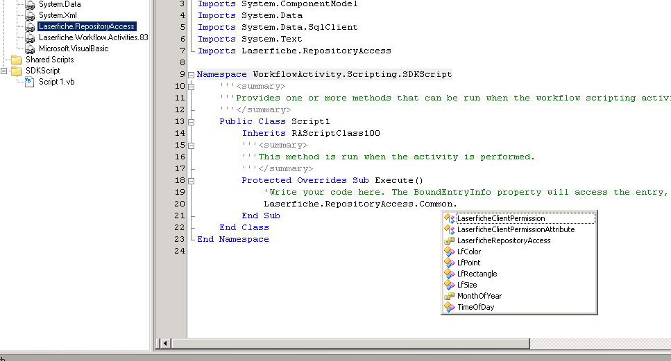

The References node in the Workflow Designer lists libraries, not their individual components. So you would not find Laserfiche.RepositoryAccess.Common.LfPoint as a reference. However, you would find Laserfiche.RepositoryAccess there, so you would have access to its child namespaces.
The Workflow Designer will autosuggest as you type similar to Visual Studio:
