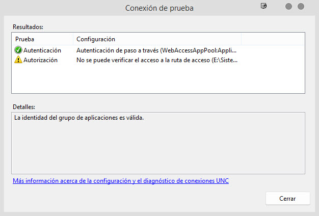

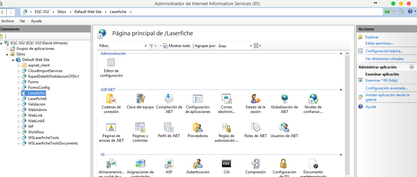

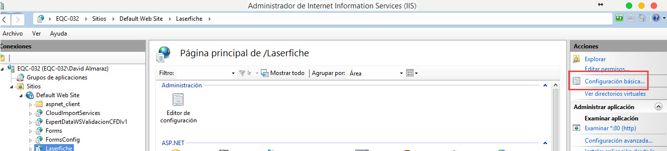

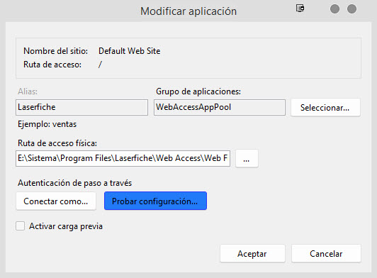

Hi Richard.
Can you check in your server IIS if you have permissions in the apps?
01 Open IIS
02 Open the web site.
03 Select Workflow for workflow and Select Laserfiche for web access
04 Then Clic on Basic settings
05 Clic on test configuration
06 Then check if both are ok if don´t
07 Select Conect as
08 Specific User and browse an user with permissions like windows administrator.
09 Then check the configuration again
after this you should be able to access on both apps.
Hope it works for you.

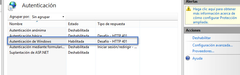

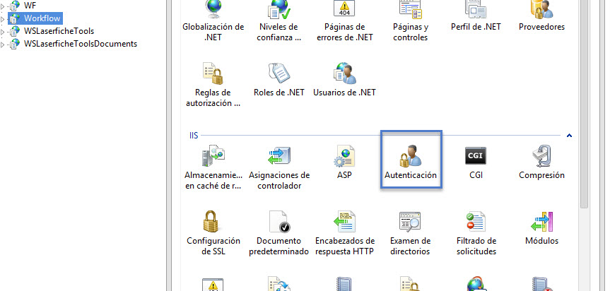

replied on October 19, 2016
Sorry to hear that.
Can you check if  in the workflow web site the windows authentication is enable?
Go to \DefaultWebSite\Workflow  and "authentication"  and enable it.
If that wouldnt work you can try enable Anonymous Authentication .
