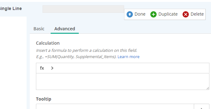

It depends on the JavaScript you wrote. Can you share your JavaScript? Also for calculating the total of some fields, can you change it to use the out-of-box calculation that Forms support which will make sure the calculation is correct when fields get updated.

Can the inbuilt calculations be used in tables with dynamic number of rows? How do i then reference the values in rows that may or may not exist?
