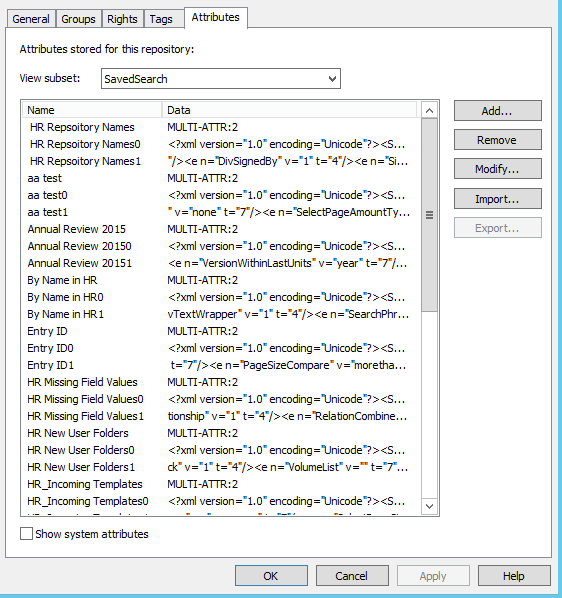

For the custom search of document types you can use the ‘Within Folder’ option and specify a default directory that you need.  That directory will be saved with your search and used each time.     Here is a simple customized search that will always search the Human Resources directory with whatever is typed into the Entry Name field.
If you setup the search templates that your users require and save them, you can then export those searches from your account and import them into your users.  They will then have those searches available within the client to ‘load’ and fill out any required fields, such as *PDF.    Open your user entry within the admin tool, select attributes and then the ‘SavedSearch’ subset.  Highlight the searches that you need and Export those to a file.    Do the same with the user that needs the templates but use the import option from your saved file.   Once the user restarts their client they will have those search templates available.
If you have different default folders for different users repeat the process, setting your search up and saving it with different default directories.
