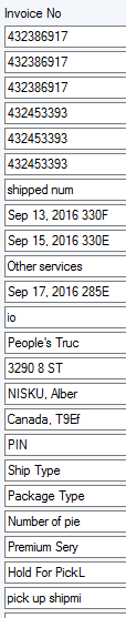

  • It is working perfectly, but is also trying to grab information off the support document pages.

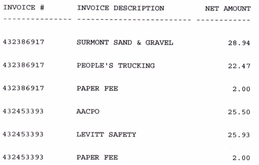

Part of the Voucher Report:
 and what is captured:

My initial thought is that you need to use pattern matching to only return valid invoice numbers. My question is: Are the invoice numbers always predictable like in your sample here? You could use a pattern match regular expression like \d+8 to grab only 9 digit numbers in your token accumulator. I think you'll have more success filtering what information is grabbed that way than trying to decide which pages to look on.

Unfortunately, the invoice numbers change per vendor and there is no pattern.  the only thing I have come up with to help would be to change the QF Session each time I run it so that the zone OCR settings are all for one page, or two pages, or three pages, depending on which one I'm going to run it on, but... still would love to see other options before settling on that.

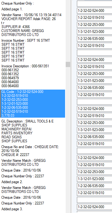

Also, why does the Accumulator repeat the entries for the GL Codes?  It repeats the GL codes from the second page sixteen times, but doesn't repeat the GL codes it grabbed from the first page.  Ahh... a clue:  there's 17 pages in this scanned document.  But I've told the zone OCR to process only pages 1 and 2.  So, once I told the pattern matching and all token accumulators to process only pages 1 and 2, it stopped repeating.  It would be nice if I could go to just one spot to make that change each time I run this QF session.
