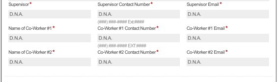

Any suggestions on how I can get my form to look like the below?  I need the fields to save to the repository with a background color.  I've attempted to use both of the below in my CSS.  I can get the Field to change in the pre submittal form, but not in the tiff which is saved in the repo.

Hi Andres,
The reason for this is because your CSS rules operate on input and textarea elements; however, when a form is stored to the repository, these are converted to div elements, so these rules no longer apply. You can use the following CSS and it should work:
.ro input[readonly], .ro div[type="text"] {background-color: purple !important;}
input[type="text"], textarea,
div[type="text"], div[type="textarea"] {background-color : #d1d1d1;}
Just out of curiosity, what is the use case for setting a field background to html purple? It seems rather dark. Or is this just a sampling of a fuller style with other rules excluded?
