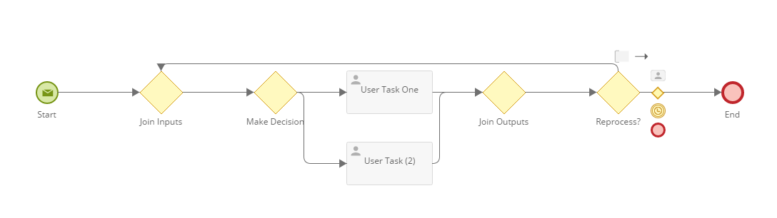

You can send a form back for reprocessing.  You do need to make sure that the approver has permission to edit the form or has additional fields to fill out so that a reprocess decision can be made.
This simple flow shows an initial decision and secondary decision at the end to determine if the workflow should be reprocessed and possibly sent to a different approver.
If you have already saved the form to the repository I think you would need to invoke a workflow to delete the original form so that it could be resaved.   Or just save the form after all decisions have been made!
