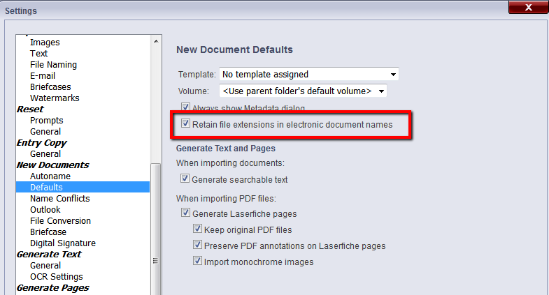

I can reproduce when the file extension (e.g., .pdf, .docx) is not retained in Web Access 9.1.1.272 (Service Pack 2). It seems the name compare fails in this case. It works in Web Access  10.1.2.286 so it was fixed at some point.
If you are unable to upgrade, you can change the file extension setting here:

Hm, I'm not sure if I made this clear, so I just want to double-check:
The document currently LF needs to have the extension in the name. To best see if the workaround works for you, you would need to import a new document after changing the setting, then try downloading, modifying, and re-importing the document.

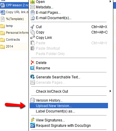

Note that there is a way to manually import a document as a new version if that will help you:
You can also add this as a button to your toolbar to reduce the number of clicks.

Thanks Brianna, that worked, when I uploaded a new document it retained the .docx, and then download/change and replace worked after.

Took me a bit to figure out why the version thing wasn't an option but I got that now too. I would have asked that as well so you saved us both time haha.
