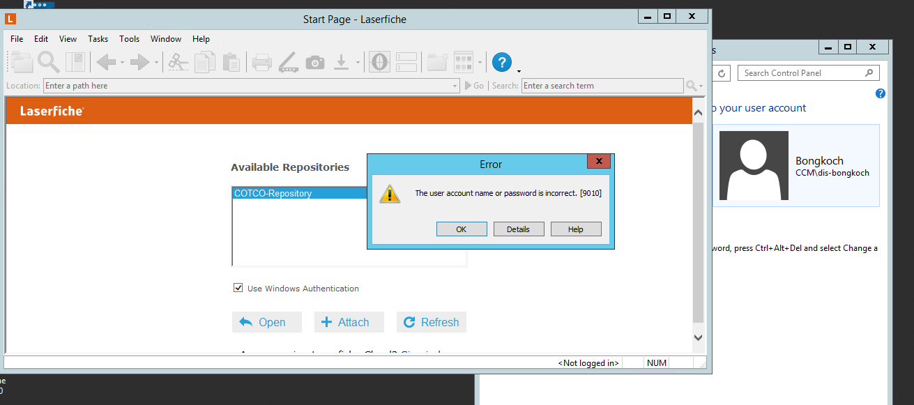

"The user account or password is incorrect. [9010]" error occurs when logging into a repository with Windows Authentication
asked on October 11, 2016 Show version history

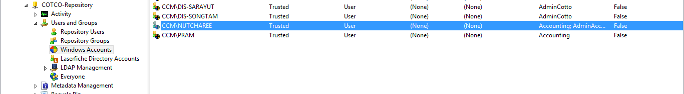

I have trouble logging into a repository by specifying AD credentials and I 've already done all the following steps.

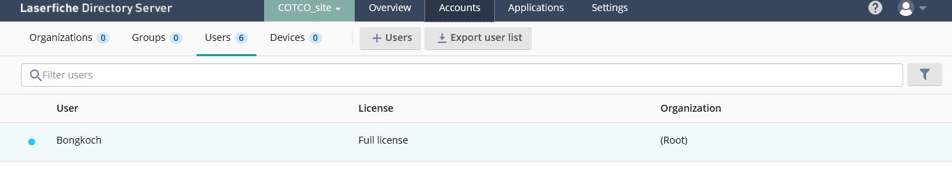

  1. Assigning a license to each AD User in LFDS.
  2. Assigning all the AD User as a trusted-Authentication with admin group which is highest priority.
Here is the error message and its details;
Error Code: 9010
Error Message: The user account name or password is incorrect. [9010]

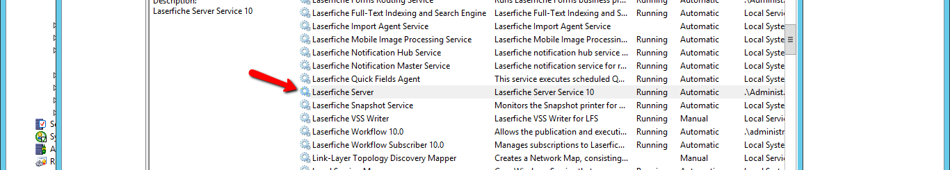

replied on December 1, 2016

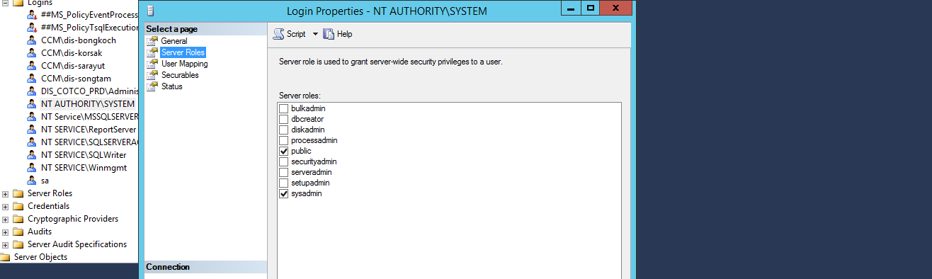

A support ticket was created for the issue. It turns out to be related to the LFDS Service logged on account. It was a local account (.\administrator). After changing it to a system account, and granting the account sufficient rights to SQL Server as Windows authentication is being used to connect to SQL, things work fine.

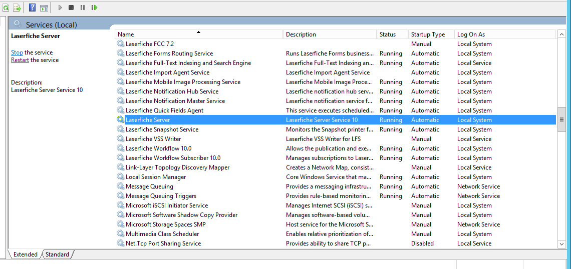

replied on October 11, 2016
Hi Bongkoch,
Try re-starting your LFS server service. It takes a little while for the users to sync to the LF server from LFDS. You can force a sync by re-starting the LFS server service.
Hope this helps point you in the right direction! yessmiley

replied on October 12, 2016
Hi Bangkoch,
It was the LFS service I was refferring to on the Laserfiche server. wink

Ah ok cool. Double check that the user you are trying to log into the repository with is explictally named in the windows accounts, then try logging into windows as that user and login to Laserfiche using windows authentication. If you are still having issues it may be that the LFSNU.db file is corrupt and needs re-creating. I would also raise a support case if you are still having issues as it could also be a port issue and they will help you troubleshoot this further.

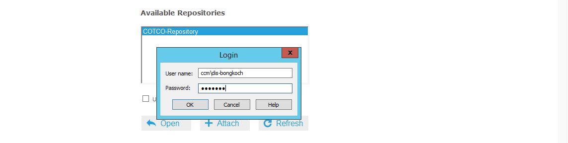

Are you trying to log in as a user that's different from the one you are logged into Windows as?  If not, you can just use the "use Windows authentication" checkbox.
replied on October 11, 2016 Show version history
Hi Brian,
I've tried logging as my AD into the server and ticked the checkbox.
And the error messages still remains.
Anyway, thank you very much for your help.
Thanks to support team and spacial thanks to Xioaxiao yan.
You did great job!
and this is the way to change from local account to local system account and and granting the local system account sufficient rights to SQL Server.
Hi Chris Douglas, I hope your issue has been solved.
