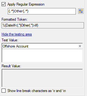

replied on October 7, 2016
Not sure if this is what you are looking for. But from my understanding if the words are "other account" you only want to see "account" if the words are "Offshore account" you want to see "Offshore account". If that is the case, the following worked for me    (.*)other(.*) This allowed words before and after the word "other" to be seen.
Thanks for your reply this works for other account but Offshore Account is not working for me.
