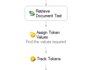

Was wondering if I am able to get some assistance in using Regular Expressions. I need to find the largest amount figure in an invoice using Workflow and Token

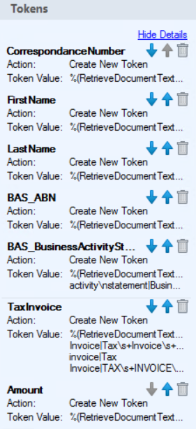

Using \d+[.][\d][\d] gives me the first match on the page which is not usually the total. Some of the process is below, I have also used the Track Tokens to see if all data is being picked up,
I have 7 tokens that are being read correctly as it is only finding specifics Document Name etc. But, would love to have some assistance regarding Totals?

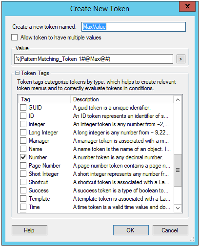

Here's the strategy I would use:
  1. Create a multi-value token with all the amounts on the page. You can do this by using your existing pattern and choosing the "All matches (as a multi-value token)" option.
  2. Create a new token called something like MaxValue, whose value is created by using the token editor "Max" function on the token from step 1. Be sure to check the box for 'number' in the 'token tags' section so that Workflow can apply the correct 'Max' function for this type of data.
Step 2 will look something like this:
replied on October 5, 2016
Hi Tessa,
Thank you so much, that just resolved the issue I was encountering, making it so much easier to find the max value = the total value of the invoice.
