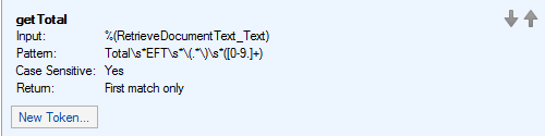

We have a Workflow that runs a calculation (Token Calculator) and compares it to another token (Pattern Matched Text).

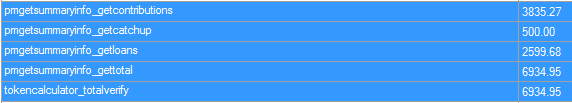

When I look at the Tokens gathered (gettotal & totalverify), it shows me that the two tokens are identical.
However, when I look at the conditions tab, I can see that the token from the Token Calculator has 11 extra digits.

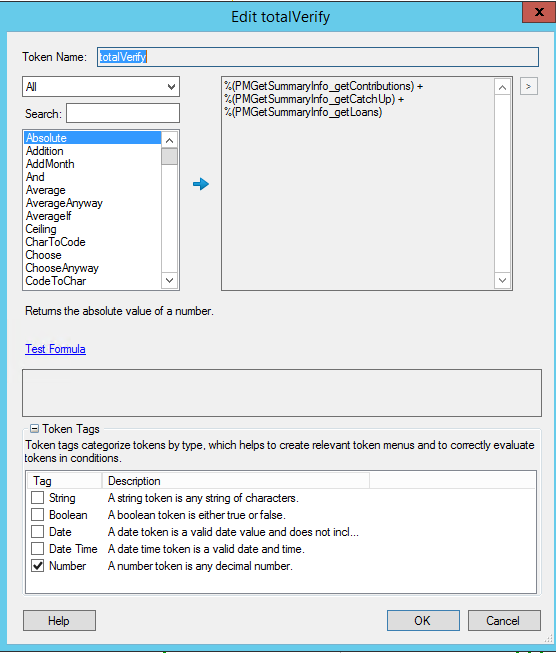

After reviewing the Token Calculator, I see that it is doing simple addition with numbers that have only two decimal places.  It's also tagged with the Number tag.
We're currently testing with it being a "String" tag even though I would have thought a "Number" tag would be more fitting.  Can anyone shed light as to why the Token Calculator is adding 11 extra decimals?  Thanks for any help!

While the root of the issue has still yet to be determined, for anyone else who may encounter this behavior, it seems that reversing the order of the arguments in the equality condition (which should in theory be symmetric) does not encounter this behavior; that is, check to see whether TOKEN_CALCULATION = OTHER_TOKEN rather than if OTHER_TOKEN = TOKEN_CALCULATION.

Where does the getTotal value come from?
Which token is on the left and which one is on the right on the condition?

The getTotal value comes from a Pattern Match activity.  It takes the Document Text and retrieves text after the words "Total EFT".  There's some confidential information within the Document Text so I won't be able to provide the full text.
The token on the left is "getTotal" and the token on the right is "totalVerify".
