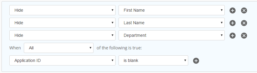

Thanks for explaining in more detail. The crux of your issue is that the lookup is running when the page loads with an empty string as its parameter - since nothing is returned, it then tries to write blank values into the return fields. Required fields don't accept blank values as valid, so the invalid input focus code is triggered.
I think in this case you can utilize Field Rules to achieve the desired behavior. Try setting up the following, which will cause the Page 3 lookup-filled fields to be hidden (and un-required) by Forms onload:
As soon as a value is entered for the lookup criteria of Application ID, they'll show up and be required.
