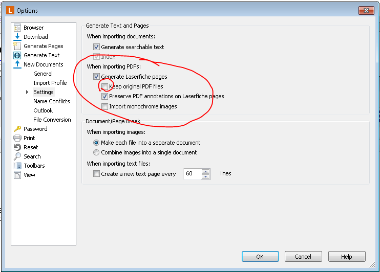

Is this Drag and Drop/Import. Before you uninstall and reinstall, did you check Options>New Documents>Settings and ensure that the Keep Original PDF Files was Unchecked?
replied on October 3, 2016 Show version history
Yes,  checked and unchecked it again to confirm that it was off.
10-3-16 2nd.PNG (100.31 KB)

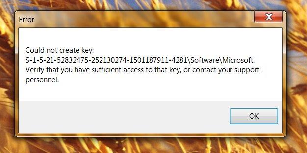

Raymond, It wasn't working for any PDFs.  An uninstall and reinstall was done and that fixed the issue with the PDFs.
The initial install was pushed to the user via Dell's KACE software.  During the evaluation of the PDF issue it came to light that she see an error message show up after logging on to her laptop in the morning stating it could not create a key.  The key information matches LF license key for this user except for the last 4 digits.
Any thoughts as to what that might be?  Something in the registry that needs cleaned up that didn't get removed with the uninstall?  Thoughts?
replied on October 5, 2016
When the software was installed, were all the client components installed? You should check a machine where the LF client was installed using KACE and compare the installed components against the machine where the installation was done manually.
