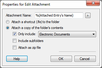

This is my current configuration.

What version of Workflow is this?
replied on September 26, 2016
10.0.0.249
I managed to fix it by correcting the attachment properties while "the selected entry is a Document" was selected, then switching it to being a folder. I thought that the document settings wouldn't influence the attachment due to Folder being selected, but it seems that is not the case.
Yes, that's exactly what I was suggesting.  I should have clarified that the option at the bottom for Document had to be selected.  Glad you got this working!
replied on January 12, 2017
The dialog was not sized properly and the folder properties were cut off in Workflow 10. This issue has been fixed for 10.2.
