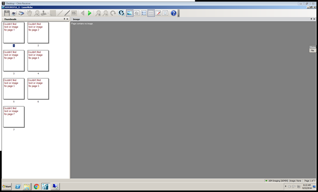

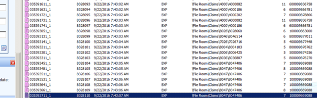

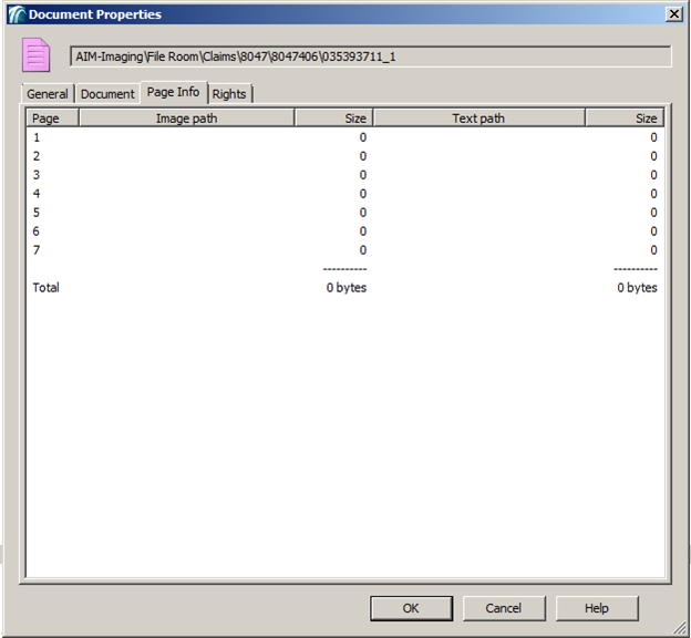

Here are some details. Seen in LF, the document thinks it has pages.
When you open the document, you have nothing:
Pages either shows nothing:
Or thinks it wrote the files:
In this last case, the files were actually missing entirely, even though the server shows file names and sizes.
